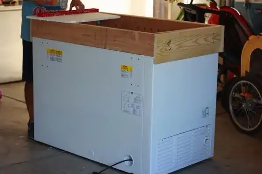

My use case is to modify a chest freezer by adding a "collar" between the lid and the chest to allow for running beverage lines into the chest freezer. This is a common DIY project for homebrewers called a "keezer". Here's a photo of a typical example.
example keezer collar
Often the material used to build this collar is dimensional lumber, which the builder then adds insulation to the inside of. I'd like to find out what this alternative building material is that I'd read about in hopes of using it instead.
