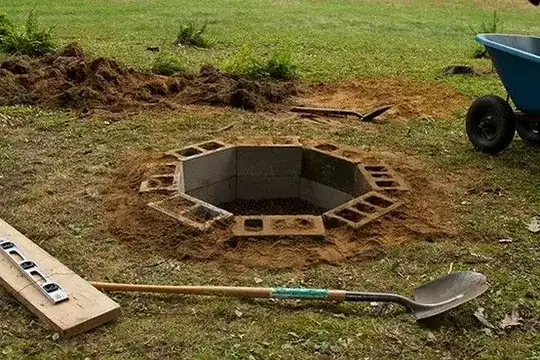

So I have happily moved on to an in ground pit. I dug my pit down about three feet into the ground about four feet long by two feet wide. There is one row of stones below ground level and two rows above ground. It was made from neighbors throw away stones - and the neighbors throw their wood in the pit. It is safe, looks good, and I just shovel it out every 3 months.
The example above is pretty close to what I have done except:

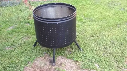

The internal bowl/barrel of an old washing machine works well for an above-ground solution - the holes around the sides allow the embers to breathe well and help to radiate heat.
Washing Machine Fire Pit
You can add legs as this person has, or simply prop it up on a slab or some bricks.
Just make sure that it IS metal - a lot of the newer/cheaper washing machines use plastic barrels, which... don't work.

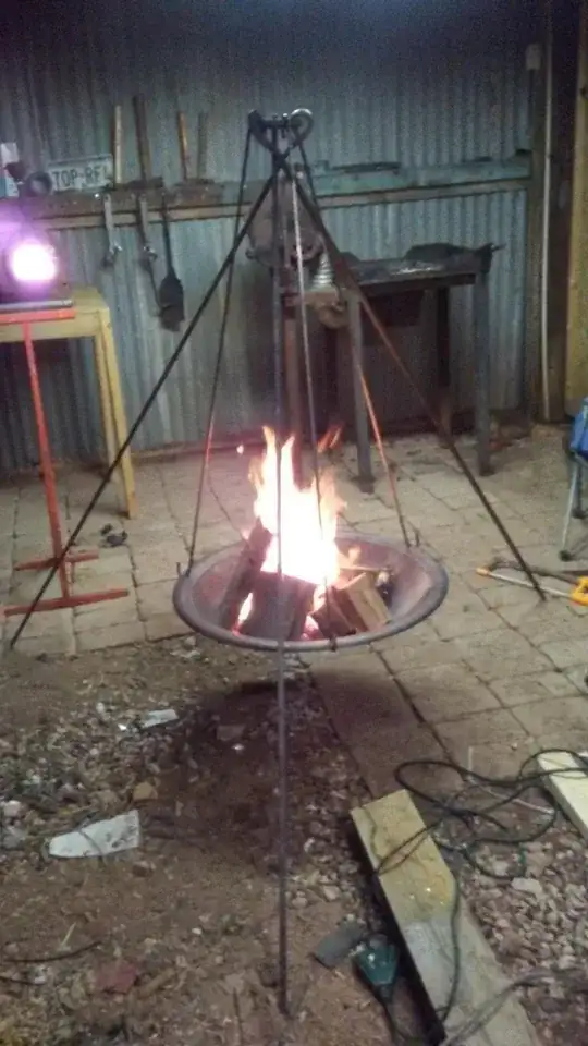

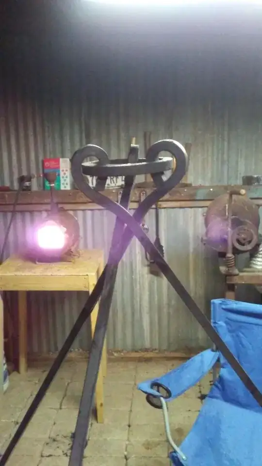

I came up with this in about an hour with stuff laying around my blacksmiths shop. Just happened to have a firebowl from a storebought pit. The tripod is made of 1/2" hot rolled square and the hangars are 1/4" sq. All in all probably 15 bucks worth of metal. Super easy to make and super portable as well, as it can be taken apart and hangs flat on a hook on a wall.

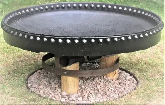

I used end of a pressurized 4-foot diameter tank I found at a scrap metal place. With some planning this is what I wound up with. I suggest a hole in the bottom for water drainage, something to cover the hole, and sand to keep the metal cooler. The pipes under the bowl are bolted into the wood and act as a buffer between the fire bowl and wood. The metal ring (2'diam) prevents the 3 posts from spreading over time due to weight of bowl. Bowl was sanded to bare metal and painted with several coats of 2000 degree black paint.
