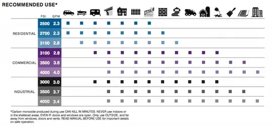

If you want to really clean instead of blasting the crap out of something the key isn't just PSI, it is also a factor of the waterflow rate. This is measured on most powerwashers as GPM or gallons per minute. You multiply GPM and the PSI to get the cleaning units (CUs) of your powerwasher. This is the most important factor for cleaning, not PSI. A lot of the big box stores sell their cheaper powerwashers with high PSI because that is what the consumer is used to looking for. These high PSI, low GPM units will not clean as well and are more likely to damage the surface you're cleaning.
Note: The chart below references usage based on staying an appropriate distance for the material and PSI. Obviously if you just look at the first column and you spray your car with a 2500 PSI powerwasher from point blank, get ready for a new pain job.
