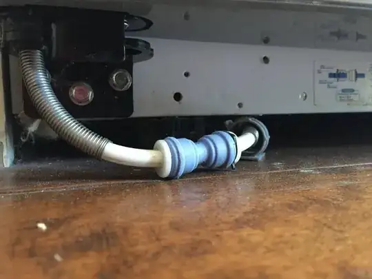

We just moved in to a new home. The former owner was in the field of risk management/disaster cleanup, and so when they put the house up for sale, they disabled the refrigerator's ability to make ice and serve water. We didn't realize this of course until after we moved in. I spoke with him on the phone, and he told me he had his plumber essentially disable the ice making/water serving abilities of the fridge. He was supposed to send his plumber out to turn it back on, but he's stopped returning my emails.
I've pulled the fridge (an LG LSC26905) out from the wall. The water line is connected just fine to the refrigerator, and I've confirmed that the water is in fact on (coming from the wall). It's a simple silver flex tube coming from the wall with a blue valve that is in the 'on' position. I disconnected from the fridge and verified that water is coming out at a very good rate. I can't figure out where the plumber might have disabled or prevented the water from flowing through the rest of the system.

So turns out the water valve in the back of my fridge was bad. All rusted out. I broke down and called a technician (thankfully) and he said we were lucky it didn't burst, as it probably would have flooded the house. On top of that, the condenser fan motor was dead.
I suspect the former owner knew all of this, and just had his guy go behind the fridge and shut off the main water line to the fridge so they wouldn't have to deal with it before selling the house.
