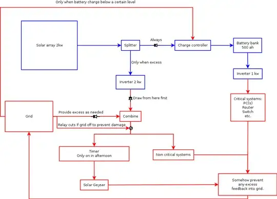

Below is roughly what I think a system that best fits my situation is like.
What I hope to achieve roughly So a few questions:
1- Any recommendations on where you would change/improve/modify this system to get better value for money, improve safety, improve efficiency or otherwise improve on it somehow?
2 - How to stop the feedback into grid?
3 - What can I use for the 'splitter' portion to ensure that power goes first to the critical system and that only excess goes to the non critical stuff?
4 - At the 'combine' portion, how do I ensure that the non-grid power is favoured first before the grid power (when both are available)
5 - How can I ensure that charge controller only takes from the AC if batteries are below a certain level, do some charge controllers already have this feature or do I need an other component for that?
6 - Given that routers, computers etc. all run DC internally would it be worthwhile looking at having them all draw directly from the battery to avoid the cost and efficiency loss of the inverter - or is it not worth the hassle?

With grid-tie being illegal, there's really not a way to do what you have diagrammed, as far as I know, and I spent several years working towards a large and complex off-grid system before local conditions changed and it became practical for me to grid-connect. In particular, the "draw from solar, supplement from grid" (or questions 2 & 4) part does not work - for non-grid-tie it has to be one or the other with a transfer switch, it can't be both (well it can be both if you double-convert, but all the AC would come from the inverter - and you'd have efficiency loss X2 for the double conversion.)
My thoughts on this type of system lead me towards the following general idea, which I may still implement alongside my grid system.
  • Pick a system voltage - I'm leaning towards 24.
  • Build battery bank - despite various fancy options, "golf cart batteries" (~225 AH/6v) seem to win the "value for money" and WIDELY available categories.
  • Do not neglect adequate DC-rated fuses on the bank.
  • Attach a good grid charger. A bad charger will murder batteries (as a UPS owner you may already know this too well - many UPSes seem to have terrible chargers and terrible battery life as a result.) One possible approach is to use a very basic (but preferably efficient) AC-DC supply and use that as input to an "offgrid" charge controller; then you'll have the charge controller you'd eventually need for your solar panels, and they are normally excellent battery chargers.
  • Use DC-DC converters to get other DC voltages you need as directly/efficiently as possible. i.e. Question 6 - yes, I think it's worthwhile where at all practical. The convenience of AC comes at a considerable efficiency cost.
  • Add a charge controller (if you are not using one as a battery charger) and solar panels when possible.
  • If the battery bank/solar capacity seems adequate, add an inverter for AC loads.
Control your use of inverter .vs. grid power by choosing where to plug loads in, or with a transfer switch. Plug control leaves the control system in your head and is low-cost.
