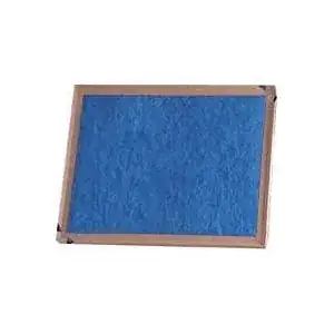

There are two main types of air filters:
The 1" thick ones that look like this: alt text
And the 6" thick filters look like this:
alt text
(source: filterscanada.ca)
Generally the 1" filters are good for a month or two. The 6" thick ones are good for 6 months.
There are also 2", 4", and 5" filters available but generally not at the local hardware store. Some folks who have 6" filters use a 2" + 4" filter and replace the 2" one every other month and the 4" once a year. This seems like a hassle to me, but it might save you $50 a year if you have 6" filters.
