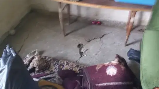

Buildings (or buying) a house on a location with a lot of water is never best thing to do, but people do it and if they do it properly they never have problems. The most important question is regarding house design; are foundations and concrete slabs appropriate for this situation. Main difference is that with underground water strongest force on the slabs is from lower side of the slab, and not from above. Keeping that in mind slabs should be thicker than normally. This picture shows what happens if that is not the case. Kepp in mind that this is drastic example and that this happened when there was "1 in a 100 years" floodenter image description here If the house is 25 year old and there are no visible damages educated guess is that there is no problem. BUT!!! Keep in mind that those sump pumps are hearth of your house...in other words if pump stop working....it's no good; also there can be some electricity issues (blackout etc.) which could stop the pumps.
