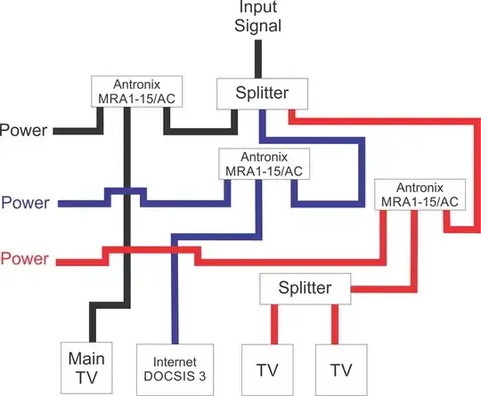

I have a long run from the pole to my house, so the cable company installed a repeater. After doing some research I'm starting to see that I'm still not getting the full signal strength to my Main TV and My Cable Modem.
Here is what I have now:
the two things I'd like to accomplish are
1 - get the best signal possible to my Main TV and to my Cable Modem
2 - Add one more TV

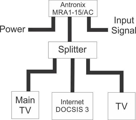

So here is what I was thinking should work:
Please let me know your thoughts on this approach or if there is a better way to do it.
TIA
M

Before going crazy adding amplifiers you might want to spend a little time investigating the current wiring/splitting situation in your house, if you haven't already.
Every splitter and every foot of cable contribute to signal loss:
  • Verify that you have only the bare minimum number of splitters in your system (in this case it seems like you can get away with 1).
  • Make sure you don't have any unnecessary long bundles of cable, or cable splices. Sometimes people will buy a long amount of cable and then just coil it all up in the basement instead of trimming it.
  • Make sure all your existing cables are in good condition: no nicks in the jacket, hard kinks (a bend is fine but a hard kink can break the interior insulation). Make sure all connections are secure. If any cable or connector seems questionable, replace it.
  • Make sure the splitter only has as many outputs as you need. A 4-way splitter will drop the signal on each leg more than a 3-way, no matter how many devices are plugged in.
If you're trying to troubleshoot signal strength, you may be able to use the config page on your DOCSIS modem, which should display the signal strength ("power level" in dBmV and "signal-to-noise ratio" in dB).
I think it's unlikely you'll really need 3 amplifiers in your house, especially if the cable company has verified that their own amplifier is providing a sufficient signal to your property. Typically the utility company is responsible for getting a usable signal as far as the exterior wall. If the above suggestions don't yield anything, you might want to call them back and ask them.
