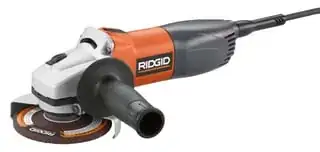

Grinder is best tool for this job....maybe even you can use the one that you have just make sure you have several plates in order to complete the job. If your grinder isn't enough 115mm one is big enough for sure....When you cut it don't just go straight down like you are cutting a butter but once you cut through wall on one side rotate your beam (or column, whatever that might be) for 90 degrees and repeat this for all 4 sides. But be really careful grinder is really dangerous tool unless you are skillful. It can be heavy and can slip from the thing you are cutting which may lead to injury. Also be extra cautious about the sparks....they can set things on fire, so make sure that anything flammable isn't around.

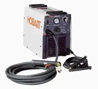

Plasma
Cost: Medium-high
Speed: Fast
Plasma Torch
A plasma torch uses a mixture of gas(es) and and electrical arc to generate a plasma, which is hot enough to melt through the material to be cut.

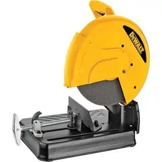

Chop saw
Cost: Medium
Speed: Medium
Chop Saw
A chop saw works similarly to a hand grinder, except that the disc is often larger, and is held an a consistent angle to the material being cut. Since it's not held in the operators hand, it provides a more accurate cut than a hand grinder.

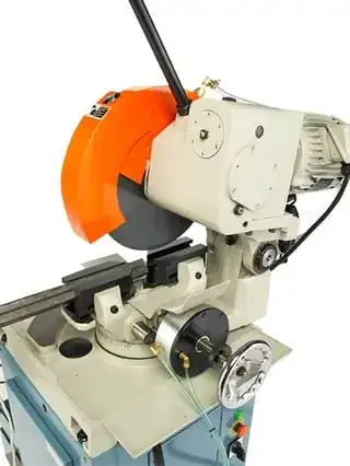

Cold saw
Cost: Medium-high
Speed: Medium
Cold Saw
Similar to a chop saw, except instead of a grinding wheel, the cold saw uses a blade with teeth to cut the material. The blade spins at a lower speed than a chop saw, and uses a coolant to keep the part and blade cool while cutting.

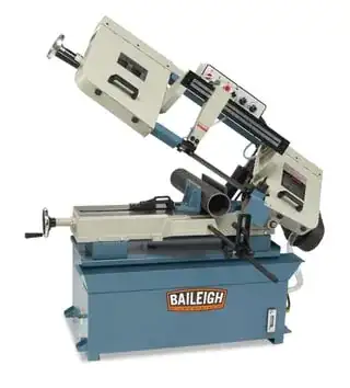

Band Saw
Cost: Medium-high
Speed: Medium
Horizontal Band Saw
A band saw uses a long band with teeth in it, which is rotated around a set of rollers to cut through the material.
Your tools are quite large enough, since none of the shapes you are dealing with will require you to make a cut more than 10-15mm deep.
Use a square and chalk or soapstone or a paint marker to mark the cut lines on the outsides of the angle and on all 4 sides of the square section. Don eye protection, ear protection, and wear boots that come far enough up your legs that your pants come down over them (hot sparks in the shoes can be quite miserable - nylon sneaker fabric melts quite nicely in the face of sparks...)
Support the steel well on both ends so that it will not sag and pinch the disk as you cut through the last of it. Cut one side and turn to cut the next. Use thin cutoff disks (1/16" or about 1.6mm - next usual choice is 3.2mm - the thinner the disk, the less steel you have to cut, the faster it goes) and go at a speed that does not bog the tool down (if you push too hard, the cut actually goes slower, and things heat up more, and you are more likely to break the disk.) Let the disk cut. Beware of twisting in the cut, as that will break your disk as well. Cutoff disks are often sold in packs of 10 or more, and that's the way to buy them, so breaking one won't put a crimp in your day.
Grinder sparks can travel far and hold heat for a while, though you are probably fine outside - they are responsible for many construction fires when steel is cut inside on a construction project and nobody sticks around for firewatch, as they skitter off into the same corners where sawdust accumulates and can smolder quietly for hours. If you are cutting outside, you might want to water the area after you are done cutting (and also before you start if it's abnormally dry.)

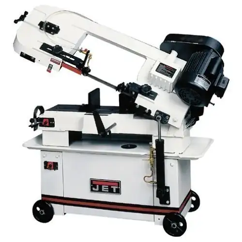

I am not an iron worker, but from what I understand the best tool for a fixed location job, meaning you have all the beams right in front of you and you can position them however you want, is a horizontal band saw like this:
horizontal band saw
There are band saw blades that are exactly designed for cutting structural steel and they work perfectly for that application.
