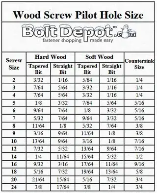

The low voltage drills like the one you have are mostly good as a powered screwdriver for assembling flat pack furniture. This type of application usually already has a pilot hole drilled, so the drill doesn't have to work to displace material as it drives the screw. The key performance parameter that your drill is lacking is a high enough maximum torque.
For a short term, low cost solution (if you don't want to spend a bunch of money up front), you could try drilling a pilot hole for the screws. The pilot hole should be about the same diameter as the shank of the screw. If you want an exact size reference, you can use a pilot hole screw chart and look up the size of screw you're using:
(Source)
If that doesn't work, you may have to buy a new drill. The newer 12V lithium ion drills are surprisingly powerful for their size, and are still rather affordable for homeowner uses. Comintern lists some good brands, but I'd also encourage you to look at Ridgid, a manufacturer who makes a good product at a slightly lower price point. This 12V drill packs a whopping 350 in-lbs of torque, compared to the 60-100 in-lbs your 7.2 drill likely has. (Note that it only comes with one battery, so you'll have to wait for it to charge when it runs out.)
