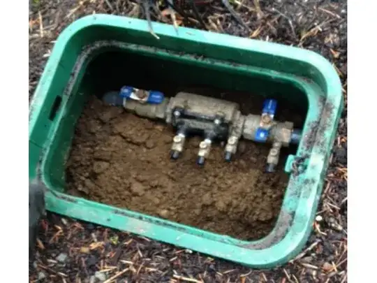

You will want to find he first / main valve box. It's usually the largest one and often rectangular. It's usually adjacent to your house, or to your water meter.
Open the cover, and identify all blowout valves. They are often quarter-turn ball valves. There are four brass blow out valves in this example with little black caps on their connections to keep dirt and bugs out: example valve box
Check that each of the blow out valves are solidly closed. It not, close it. You may need a straight blade screw driver.
Then, open the larger flow shut-off valves of which there are two in the picture above. The handle should be parallel with the pipe when it's open for every such valve I've come across. You should hear a brief 'whoosh' of water when you do this, and if you'll stay dry if all of your blow out valves are closed.
Then go to the controller and run each zone one at a time and look at the heads to confirm they're working properly. Adjust the heads if you want (though you could do that any time of year). If any are broken, flag them and call your sprinkler guy to fix (or head to his supply warehouse and buy the parts to do so yourself).
