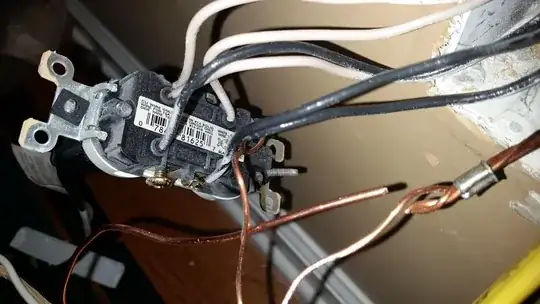

There is an additional space on the existing outlet to attach an additional set of wires (it has two push in and two screw spots on each side)

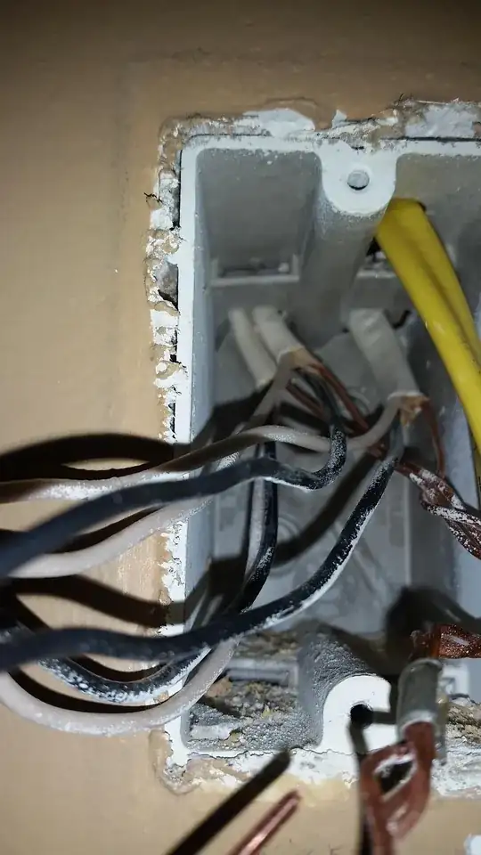

3 - I read somewhere else here about box size, from what I'd seen it looks like with the new line in the box it'll be too full, so I'd need to replace the box... It's a new work attached to the stud box, just a single outlet. I don't want to double up the outlets, are there bigger old work boxes for a single outlet?

Pic of existing outlet:
existing box: (three in the back were existing, yellow is the one I added)

Read inside the box. If you install 14 AWG conductors to the new box, instead of 12 AWG conductors. You'd need at least a 22 cu.in. Box, or a 3" x 2" x 3 1/2" device box.
  • 8 for current carrying conductors.
  • 1 for grounding conductors.
  • 2 for device fill.
11 total, times 2.00 cu.in. for 14 AWG conductors = 22 cu.in.
However, since you're using 12 AWG, the calculation looks like this...
  • 6 for 14 AWG conductors x 2.00 cu.in. (12 cu.in).
  • 2 for 12 AWG conductors x 2.25 cu.in. (4.5 cu.in).
  • 1 for grounding conductors x 2.25 cu. in. (2.25 cu.in.).
  • 2 for device fill x 2.25 cu.in. (4.5 cu.in.).
Total = 23.25 cu.in.
For more information on box fill, check out this answer
As for connecting the new wire. There should be no problem attaching it to the receptacle. However, since you're using 12 AWG conductors, you'll have to use the screw terminals.
If you want to do pigtails, you can. I know some guys don't like the backstab connections, so if you want to avoid using them you can do pigtails. Ideal 76B® Red Wire-nut® Wire Connectors are rated for 2 to 5 #14 conductors, but check with the manufacturer of the connectors you're using. Again, if you're going to do this, you'll want to use #14 conductors instead of the #12 you've installed.
