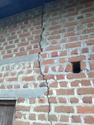

My house was constructed in 1992 and we still have not completed the finishing work. Our roof is wood, there is no tie-beam or mullion at all in this house and there are some lintels above the windows & doors.
Cracks have appeared in the masonry walls starting from 2 years after construction in some areas, and in other areas some years later. Here is a picture of one of the cracks (click for full size):
Crack on the wall
I have been advised to consult a structural engineer. What can I expect from this consultation? Are there any specific questions I must ask the engineer?
I want to know if we can continue the construction as per proper standard or if I have to demolish the house and build it again.
Our land is loose soil and there is no concrete footing on this house. If this is a soil settlement issue, there are three options as per my understanding:
  1. Continuous appearance of cracks in different areas
  2. Cracks in a certain area with width increasing gradually
  3. There is no new crack formation or growth after some year

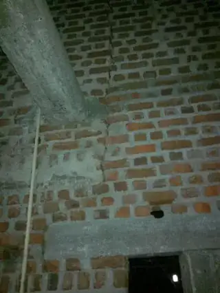

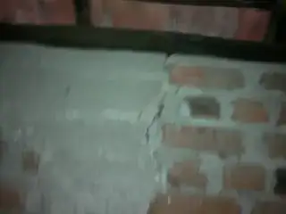

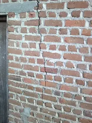

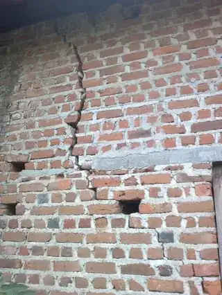

Here are some additional pictures (click for full size):
Crack on the wall 2 Crack on the wall 4 Crack on the wall 3 Crack on the wall 5

Get a reputable professional structural engineer in there ASAP -- it looks like the wall is severely cracked and would fail at that point when subject to shear loads.
I'm sure that the eyeballs of said engineer will tell a story when he sees a wall that's cracked that badly.

When the use of a proper foundation is avoided, the earth under the house WILL settle. It will settle unevenly, causing structural damage. The solution is to do extensive construction to build a support system for the weight of the house. Building without foundation is illegal by the International Builders Code.
SECTION R403 FOOTINGS
