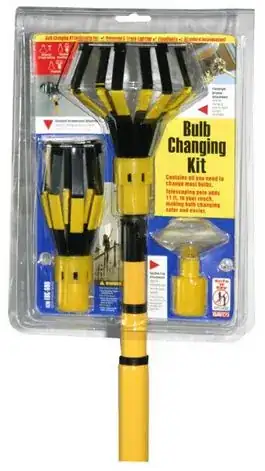

Get a light bulb changer pole at your local home improvement store or your favorite hardware store. The ones with suction cups are best for flood lights, where the face of the bulb is a little flatter, but might have a tougher time gripping smaller, rounder light bulbs where you need something that can fit up inside the fixture and grip the sides of the bulb. The same applies for CFL's or LED "bulbs" that may not have a uniformly smooth round surface. And with the extending pole, you can use something like this on an 8ft celing or a 12ft ceiling without climbing to the tippity top of a free-standing ladder.
Light bulb changer

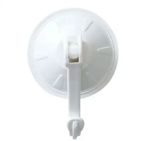

There's a company that makes suction cup hooks/hangers. You put the suction cup on an object and swing the hook. I'll bet you could attach one of these to the glass and use it to unscrew the bulb.
I found this on Amazon.
Edit: if the bottom of the bulb is highly curved, this won't work. The surface has to be flat or only slightly curved.

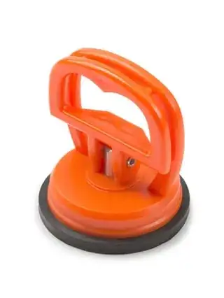

I use a suction cup dent puller to grip the glass on computers and tablets when there's no handle:
I doubt that glass is much different than the glass in the stuck bulbs, strength-wise.
