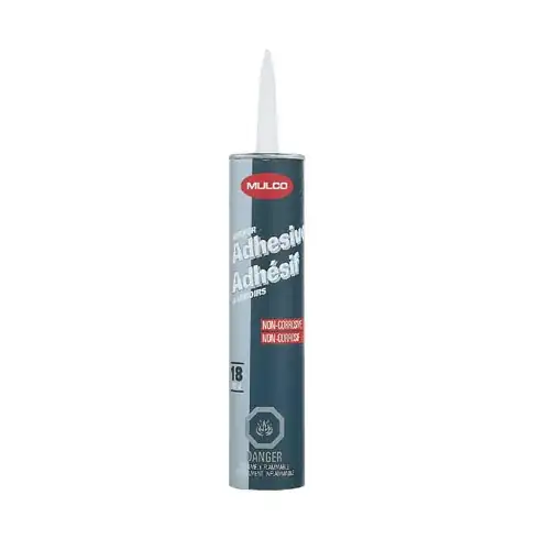

Mirror Adhesive ("mirror mastic") exists:
As for how to hold it up; rest it on something:
  • the top of the backsplash
  • rest it on a strip of wood fastened to the wall
and use mirror clips while it sets.
