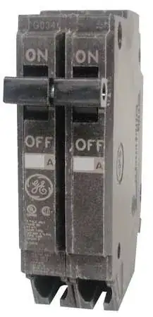

  • Replace some of the main panel breakers with half-widths (two breakers per slot) to create enough space for a new breaker.

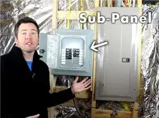

  • Install a sub-panel which is fed by a double breaker in the main panel. enter image description here

More circuits in a panel, duplex etc.
I wrote a thorough explanation of duplex breakers here, that will show your options for adding to a panel. https://diy.stackexchange.com/a/110152/47125
