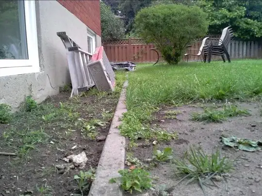

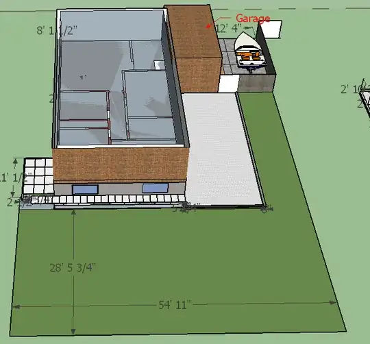

I want to fix the grading of my backyard. I think that I have two options: a) remove the sod, grade the soil and put the sod back AND b) use a rototiller (rent it from HomeDepot) and turn the old sod over
I would like to go with b) because: -the existing sod is poor quality -there is less work involved to remove and put back -I understand that using a rototiller will also help me to aerate the soil, make it easier to be graded
To get my lawn back I can either buy sod or seed and wait for the grass to grow back. This should be easy with the wet summer that we are in for here in To.
Any pros and cons ?
And here is a soil level picture

I have not had a good experience with tilling an existing lawn. The existing grass does not get shredded completely but will form lumps that make for an uneven surface. Depending on how much top soil you have, you may bring out a lot of sand and rocks. Even a small electric tiller can go as deep as 6-8 inches. If your top soil is not at least 12 inches, it will be a long and labor-intensive process to get back your lawn without spreading additional screened loam.
What a landscaper will do with a bobcat (as I have just observed in my neighbor's yard) is
  • scrape off the sod and discard
  • try to salvage as much loam as possible and dump it on a pile that is out of the way
  • grade the land as desired
  • re-spread the loam, and add new loam if needed
  • reseed
