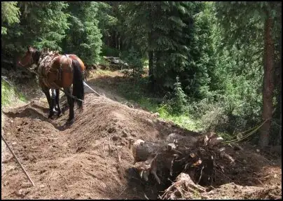

The most impressive method would be with a draft horse :)
