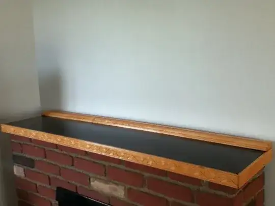

I have a plank of hardwood poplar, and I want to have a piece of decorative trim along the edge made of a different wood (probably just pine, or maybe balsam). Is there anything I can do to get a stain that will give the same shade on both woods? A specific brand, style, coloring, or way of applying? Or should I purposefully get two different stains (one light, one dark) to aesthetically set the pieces apart?
Update: Final Result
