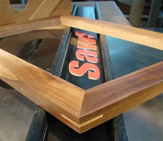

Short answer:
Put some splines in those corners! Based on the details of your situation, that is probably enough.
Long answer:
Wood movement can be a problem for frame miters because the boards will get wider and narrower with humidity changes. This means the 45 degree miters will try to stretch themselves to be slightly different angles. Here's what I would do:
  1. Make sure the corners are solidly attached. Glue might be enough, esp. if you use glue size to seal the endgrain, but I would opt for a biscuit or a spline. If they are already together, you can saw one kerf in from the corner and glue in a spline that you won't see from the front. I've used this technique with an inexpensive ryoba (japanese saw) and a piece of veneer as the spline. The spline can be thin because wood is very strong in tension.
