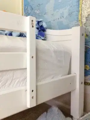

We bought a bunk bed and installed both of them on the floor. Through extensive kid use, the partial-length side rail worked loose -- twice. I suspect that the bunk ladder would have provided more support. As you might be able to see in the picture, I already tried adding screws, but it wasn't enough.
I found this diy article about a loose side bar, and Ecnerwal's answer, but I don't think the frame of the bed has enough thickness for the bed bolt. At least that's a better idea than my first one, which was a thru-bolt -- there's not enough room on the inside of the bed frame before the mattress.
My latest idea is a metal bracket that would wrap around the vertical post and screw to the frame on either side. I don't have a vise to bend something, though. Are there joist hangers small enough? Would small L brackets be enough?

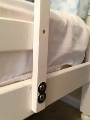

Updated: I used carriage bolts at @mazura's suggestion, and fender washers on either side of the wood rail, ending in a basic hex nut. Got all the hardware for $2!
Before: loose bed rail
After: final product, a braced side rail

Bed joist seem to not suit to the job here. Different kind of structure work. Your vertical element here works now as cantilever, while in former role (as a ladder as I suppose) it was supported as a continuous beam, which part was hanging up (if your bed is the upper one) or was to be tied as end of that ladder (if your bed was the lower one). Similar tensions, yes, but distributed differently .
I have two suggestions:
  • Use your two bolts, but with metal plates.
    Your bolts probably worked too much on the wooden element's structure, and became loose through time. Try to put metal plates (regular steel plates that carpenters use with wood structures) between the bolt/nut and wood, use double nut. That would help to distribute the load from the steel bolt to the wood more 'per area' (crudely speaking) and avoid local deformations. A double nut may help prevent the first nut from unscrewing itself.
  • Your idea with metal bracket is good.
    Using a clamp-like metal element wide enough (to make a torque) and steel plates (small ones would do) on the interior side of the bed is a good option. If you can't find that kind of shape, just buy simple perforated steel carpenter plates (as in suggestion no. 1) long enough and bend them to suit your desired shape.
If you can't visualize anything from my text wall (sorry about that), I may try to produce some drawings, but I need time with that. Also, more answers - more choices. I encourage other DIY-ers to post their answers, too.
