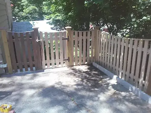

Here are some pictures. First, from the driveway side; note the curb down the wall on the right:
Driveway side of walls

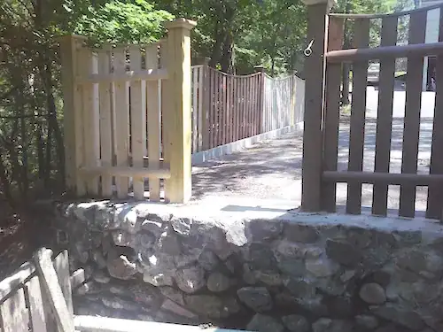

Second, from the back of the shorter end wall. I'd want to have water coming over the corner at the left, but protect the wall from the water:
Back side of shorter wall

Honestly, I would imagine your walls will be just fine with a little water running over them. The stone walls all over the Irish countryside have been standing for a year or two and seem to cope with the wet, cold North Sea coastal weather pretty well, and most of those aren't even set in mortar. ;-)
What I definitely would do is consider what kind of footing the wall is built on. If there's a chance of water running down the wall and digging a trough at the base that undermines the wall, you might beef up the footing and/or build in some drainage.
