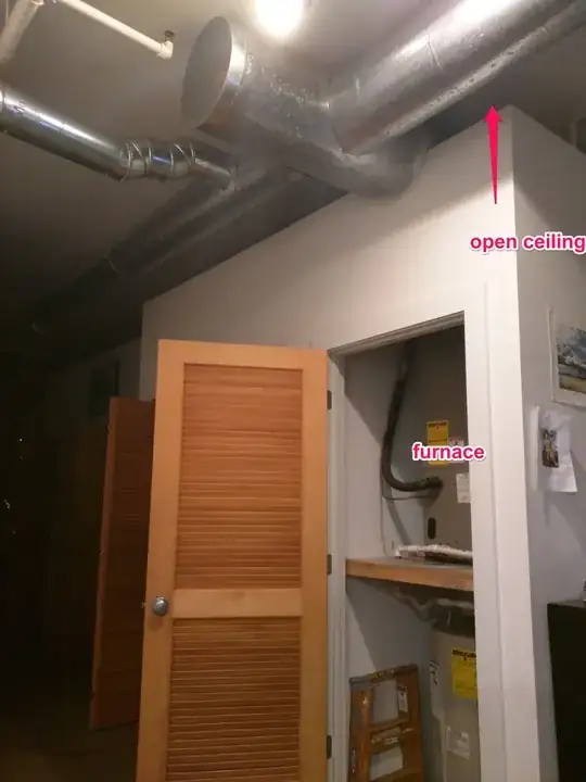

I have a Goodman AR42-1 air handler unit in an open closet. The setup looks like this:
Air handler setup
When the air handler activates it sounds like this:
https://youtu.be/XTcLtrniQB8
Current sound levels:
Everything off:           36 dB
A/C on and inside closet: 63 dB
A/C on with door closed:  59 dB
A/C on in Living Room:    55 dB

I don't have air handlers, but I am into audio.
Air going thru pipes is like a speaker. It makes noise. Make sure everything is tight. It may sound crazy, but I put a 2 inch plastic pipe to my ear and "pin point " where the noise is coming from.
Once all that is done, wrap the pipes. Improves efficiency as well.
