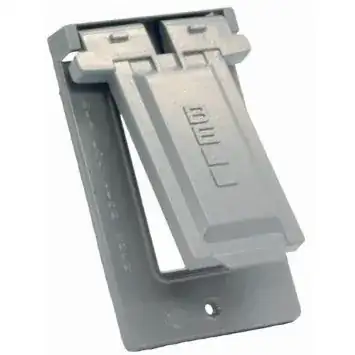

@ user770395, Tester101 is correct but you also have to use a Weather Proof Cover when the receptacle can come into direct contact with water. I would use a In-use cover(1) but you could use a Weather Proof Cover but not a In-use cover(2). The in-use cover can still be shut and protect the outlet, while the not in-use cover can not.
