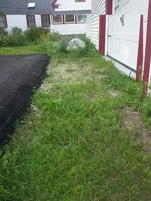

I recently had a new asphalt driveway installed.
Due to the slope of the driveway they stopped about 2 1/2 feet from garage. This has created a problem with the end of driveway being 5 1/2 inches higher than the garage floor. This makes it extremely difficult to get motorcycles in and out.
Can anyone suggest a solution to fix this? I don't want any boards or anything like that but something that looks like it would belong there.

Looks badly done - grass should have been removed before paving, grade fixed if needed so water won't run from driveway into garage.
For a crude fix, place a slot drain right up against the garage to divert water, and infill with lots of "cold patch" to make the slope inbetween as smooth as possible, rather than this huge drop at the end of the pavement.
For a better fix, hire a different paving contractor...

In your situation, since you have soil between the asphalt and garage as well as a decent amount of space, digging out a drain trench between the asphalt and the garage will let you put in a length of slotted french drain pipe to control water and use rock and pavers to smooth out the difference in heights of the two surfaces.
Dig the trench a couple of inches deeper than the pipe to allow you to wrap the pipe in weed blocking cloth (to keep it unclogged), then fill in the space around and above the pipe with whitewash rock. Fill in the rest of the area with the rock sloping the surface until you have about 1 1/2 " edge of asphalt and garage showing above the rock. Cover the rock with 12x12" landscape tiles (gray color if you want them to not be noticable, red ones if you want to make the spot more safely marked). You can then run your motorcycle over the area smoothly. If you happen to run a car tire over the area, the tiles are large enough to take momentary pressures since supported by the rock. I have put in a couple of hundred feed to french drain using this method and it works fine to control the water, makes a decent walkway and always looks nice. Good luck.
Been there, done that; landscape fabric and crushed stone.
