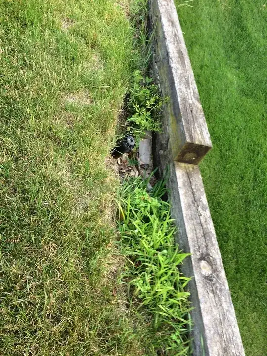

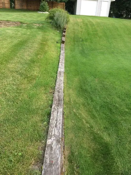

My timber retaining wall is falling over, I'm just wondering what my options are? Is there a way to fix what I've got, or will I need to dig this whole area out and rebuild? You can't tell from the pictures but it's about 3-4 feet tall.
Photo: enter image description here enter image description here
Dan Williams
  • 225
It's quite hard to tell how big this wall is but you stated it's 3-4' tall.
It looks like it was built simply as a vertical wall. There's nothing you can do about it. It was inevitably going to tip over. So yes, you do have to dig it out.

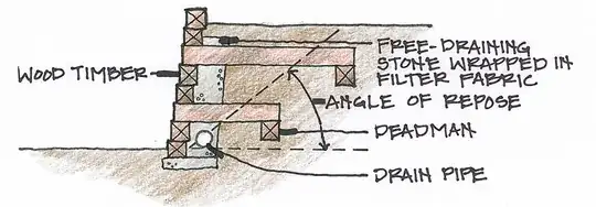

If you want to replace it with timber, you need to add something called deadmen to it. A deadman is a timber that runs perpendicular to the wall itself that is then attached to another timber that runs parallel to the wall itself. Diagram:
Without those, your timber wall will always end up getting pushed over eventually.
The catch is, of course, to bury the deadman, you need to excavate all the dirt behind the wall back to about the same depth as the wall...so you'd be moving the 4' of dirt behind the wall as well. That may or may not work depending on who's side of the yard that is.

Classic example of a simple retaining wall built vertically - they ALWAYS fall over (except in the case of a LOT of permanent structure behind the face of the wall, making it more like one face of a box you can't see three sides of.)
You'll have to dig.
When you replace it, replace it with a wall that slopes, at least slightly, into the hill (ie, if it's 4 feet tall, the top should be 2.5-4 inches further left than the bottom, in this picture.) If you want to improve it further, also cut in 3-4 foot long timbers (if resusing the timbers or rebuilding it in timber) going into the dirt at the two foot level, every 6-8 feet. The goal is to make it VERY hard for the wall to be overturned. Sloping it puts the weight of the wall to work for you, rather than leaving it balanced between "dirt that wants to move" and "thin air" - you unbalance the wall to press against the dirt. Cross timbers add to the difficulty of turning the wall over by requiring a good deal of the dirt to lift up and tip over. That effect can be enhanced even more by fastening a buried timber parallel to the wall on top of the far ends of the cross timbers.
