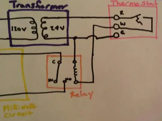

You'll need a transformer to step down mains voltage, to 24 volts that the thermostat can use. And you'll need a relay that can work with 24 volts.
You'll wire it up something like this.
millivolt thermostat control
When the thermostat calls for heat, the relay contact will be pulled closed. This will signal the fireplace to turn on.
NOTE: the three contacts used on the thermostat are R, W, and C. In the drawing the C may or may not look like a C, so I just wanted to make that clear.

A) Transformer. B) Relay or electronic relay, 24V in switching whatever on the output side.
