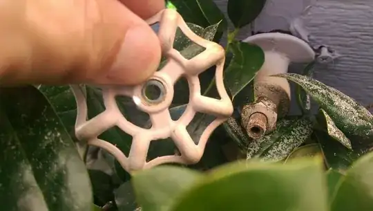

Outdoor faucet handle and broach I have ordered several faucet handles but every one has been too large, or the wrong shape (square). Home Depot and Lowe's have handles but all too large or the wrong shape. Universal Outdoor Faucet Handle - too large/wrong shape. House was built about 12 years ago. Is this faucet really that rare? I would appreciate your expert advice, this has become frustrating.

If that's a picture of your actual hose faucet, then you just need to use a screw to attach the handle! If that pictue is just something that you took off the net, how closely does it match your's?
It's probably a #8-32 x 3/8" screw... probably 3/4" long.
