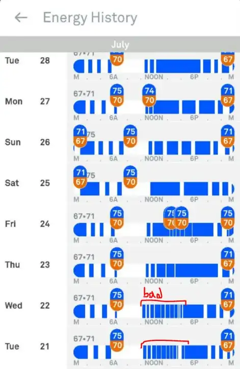

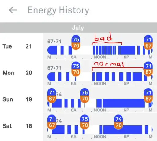

Here's a photo that shows the daytime shutoffs yesterday (Tuesday) between noon and 6pm as compared to the days prior. Notice that in the night and early morning it operates normally.
Tuesday weirdness
So what's happening? Is it overheating?

Actual, better answer:
The heat pump was definitely overheating. Since the heat wave has passed, there have been 0 issues. The ambient outside temperature is 90-95 °F this week, whereas it was 103 - 105 °F last week. This seems to make all the difference as things are purring along and the home is staying cool. Thanks for the help everyone!
