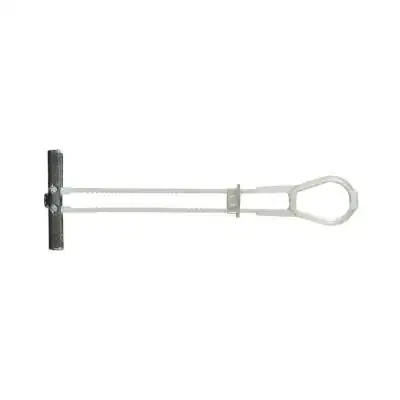

For ceiling mounting, try very hard to find framing members. If that is not possible, use anchors that have significant perpendicular members, such as molly bolts or toggles. I favor strap toggles like these
strap toggle
But I really urge screwing into framing if at all possible.
