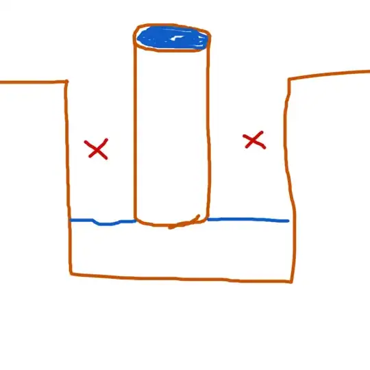

So I am pouring some footings for a deck I am building and my current plan is to dig a hole that is 18" wide and 18" deep. I'm then going to suspend a sonotube about 6 inches above the bottom (using a scrap wood frame).
My idea is to pour concrete in through the sonotube and have it splay out at the bottom, but once the concrete fills the bottom of the hole up to the sonotube, that it stop filling the hole.
I'm not sure if that was confusing or not, so I drew a crude picture. The blue line is as high as I want the concrete to go in the hole. The red "X"s should be empty space in the hole and the sonotube in the center should be filled with concrete.
My question: If i take this approach will the concrete fill in as I have drawn in the picture, or will the concrete in the sonotube keep pouring out and fill the hole all the way to the top?

This is a reasonable concern, but not necessarily a problem. It is not uncommon to have concrete forms the way you describe. The solution depends largely on the consistency of the concrete mix. A very wet mix will run all over the place, a very dry mix will hardly flow out the end at all. This property is known as the "slump" of concrete, measured in inches. Slump value range from 1" (very thick, hard to work with) to 6"+ (very liquid).
If you are mixing the concrete yourself, aim for somewhere in the middle. If the concrete is being delivered, talk to the supplier about your use case and they should help you.

I poured three Deck Footers (Stairs) - two 10" tubes, and one 8" tube yesterday in 45 degree weather, and each about 30" in length. I filled the concrete to the top of the tubes. The tubes were each about 12" above the hole bottom, and the holes were between 12-14" in diameter - the concrete went down the tube and filled the bottom approx 12" deep cavity below the tube bottoms, and then rose within and inside each tube, without the concrete squeezing down further, and 'oozing' up the outside of the tubes.
I made the mix with a rental electric mixer from Home Depot - highly recommended, and less than $40 for 4 hrs, and used slightly more than the Sakrete bag instructions of water for Sakrete 50 Lb Fast Setting bags - 2 Gallons for 3 bags (2.5-3.0 Qts per bag, or roughly 2 gallons for 3 bags). WORKED GREAT!!!

Agree with Henry, as long as you can hold/get the tube stable you'll be fine. Use a nice rolling mix, not too wet and use a length of rebar (or wood in a pinch) and drive it in and out of the concrete to act as a crude vibrating poker (gets rid of air and avoids empty pockets).
I'd probably try a slightly dryer mix until you get into the tube to reduce the 'slump' in the bottom of the hole.

How about pour the concrete around the tube first, letting it set a short time, then pulling the tube up, embedding a couple of pieces of rebar in an X formation across that hole, then lifting the form and pouring the rest? That;s what I would do; if I were doing that.
