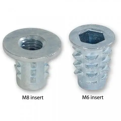

Threaded inserts
You can put a threaded insert into a wooden stud (or into a wall cleat as above). This allows you to use a machine screw (bolt) instead of a wood screw. A machine screw into a metal insert will stand up to repeated removal and replacement better than a wood screw.
Just one (or two) of these could be inserted into a wall cleat and used to lock the other cleat into position.
Alternatively, if you have wooden studs in convenient positions you could use these directly in the stud. It might be a little fiddly to align everything when reattaching your item to the wall.
Some inserts are hammered in, some screwed in using a hex drive (allen key). You need to drill the correct sized hole to receive the insert.
