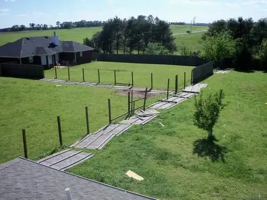

Edit: Here's some pictures of the fence line:

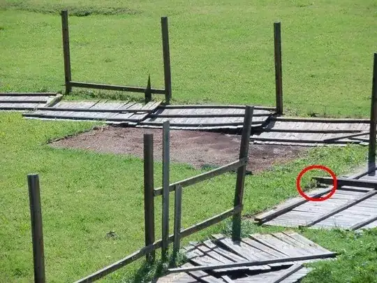

And here's where the fence post is snapped:
That big spot without any grass is where my neighbor's shed used to be before the tornado carried it off.

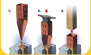

I would use something like a MetPost repair spur. You drive it into the bottom of the old post and then fix the new post to it.
iamge taken from MetPost website
