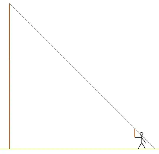

Find a stick the same length as your arm. Hold your arm out straight and level with the stick pointing straight up (90° to your outstretched arm). Walk forward/backward until the tip of the stick coincides with the top of the tree. Your feet are now at approximately the same distance from the tree as it is high. (For a more precise approximation, back up by the additional distance of the height of your arm above the ground.) The relationship is true only if the tree is significantly taller than you are, and the ground is relatively level. Time-tested logger method. Simple.
creating a right triangle with the line of sight at a 45 degree angle.

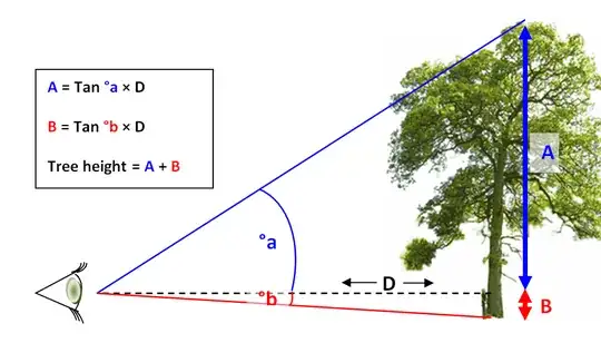

You can do this with some basic trigonometry (bring your calculator), if you have a way of measuring the angle (eg, using a digital protractor, laser level that has a protractor/angle tool, angle ruler, etc).
illustration of using trigonometry to measure tree on slope ground, viewer is not level with tree.
  • D is the distance between you and the tree
  • a is the angle to the top of the tree
  • b is the angle to the bottom of the tree (if you do it from the ground, you don't need to bother with measuring b)
So then you just use the tan button on your calculator to find:
  • A = Tan a * D
  • B = Tan b * D
    • (you can also just estimate/measure B directly - if you're standing on level ground with the tree, it's the height of your eyes or wherever you measured the angle from)
  • Height = A + B
This method also works even if you are standing on ground that's at a different height than the base of the tree - eg, you can be on a hill, standing with your eye-level half-way up the tree and it will still work.
(from http://sylva.org.uk/oneoak/tree_facts.php)

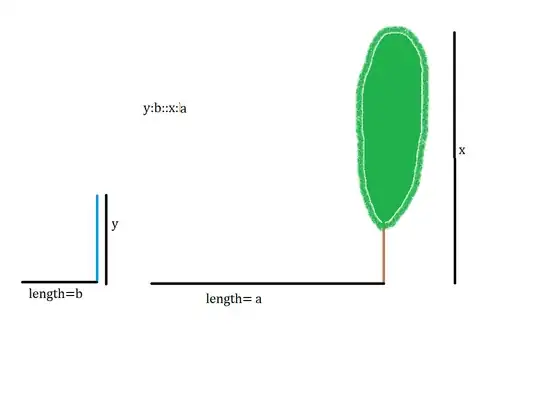

It's Easy.
Let's consider the height of the tree is x. Measure the shadow length of x.
Take a Stick and measure it's height. Measure it's shadow too. Let's say stick is "y" tall and it's shadow is "b" long.
Do the proportion. y:b::x:a. We need to find x. Do Y*A. Divide that answer with b. That answer is x and therefore it is the height of the tree.
