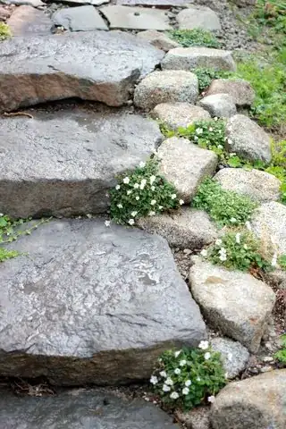

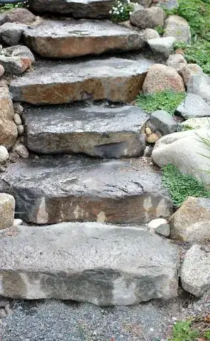

We live in the PNW and as Tyler Durden said before, think stone. Buy big stepping stones and supplement with the cheapest one man boulders you can find at a local stone / landscape store. While our hill isn't a steep as yours, I'm sure that they would work on your slope.
No concrete required, just a bit of preparation. Tyler's preparation sounds good, except that we used "base rock" over sand. It's finely crushed stone and a little heavier then sand, so washes away less easily. Use a tamper to tamp down the base before placing the stones.
Our stairs will definitely last longer then our house.
stone stairsstone stairs - closer
