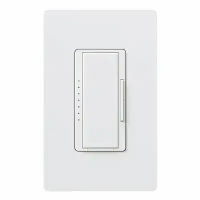

  • Purchase 2 Lutron RF Maestros. ( The RF part is important, as they sell none RF Maestros too) ( for non dimming use MRF2-6ANS ) enter image description here enter image description here

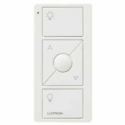

  • One Pico wireless switch enter image description here

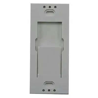

  • One Pico switch plate adapter enter image description here

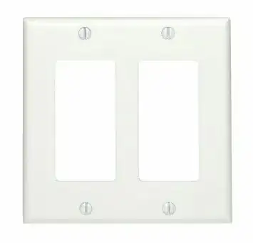

  • One 2 gang decor plate enter image description here
  • Change both switches to the RF Maestro and put the Pico next to the switch that controls the recessed lights using the Pico adapter and 2 gang wall plate. (No cutting necessary).
  • Program the Pico to turn on both RF Maestros and you're done.
  • If using electronic or magnetic LED the Maestro will need to be compatible and same goes for the recessed lights. But since you are not dimming these you do not need to worry about that nor would you need to worry about the wattage.
