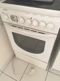

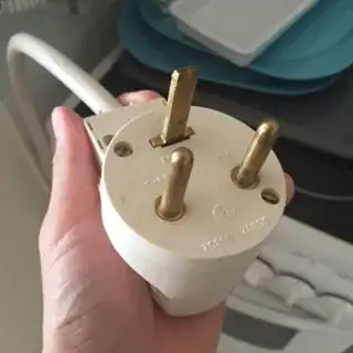

Trying to use a second-hand oven (bought in France) but it has this strange plug I've never seen before:

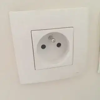

The wall sockets in the kitchen are just the usual EU one:
I searched the hardware store for an adapter, but could only find the inverse direction. And if I search for "four monophase adaptateur" ("four" is oven in French) then I also only see pictures of adapters going the other direction.
What is the plug? Is there such thing as an adapter to convert to a normal socket, or some practical reason why this only possible in the inverse?
If there is no such adapter, what will be involved to get this oven working - will it be as simple as wiring up the correct socket into the wall, or there may be more involved?

It looks like an NF C 61-315 standard French single phase plug:
NF C 61-315
These are are rated for 400V, 32A on a single phase. The socket you have pictured looks like a French style Schuko (CEE 7/3), which is typically only rated to around 16A. My guess is that unless you already have a socket that was intended for use with an electric stove, the wires are likely not a suitable gauge to handle the current demand.
If you have an outlet with the appropriate wire gauge, it would probably just be a matter of replacing either the outlet or the plug. If you have any doubts, I'd consult an electrician before attempting to connect it.

I'm from the US, but I know about electricity from other parts of the world. This plug/cord you have here is probably a NF C 61-315 single-phase French plug. You have to replace the Schuko receptacle with the one listed above.
