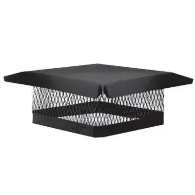

Sounds like you need a chimney cap
chimney cap
These come in a variety of sizes and shapes. They keep out most rain and snow and, most importantly, animals.
You should attach any cap with stainless screws and lead anchors. Sealant is not a big issue, since there is no need for air or water tight joints. While sealant might hold in most conditions, strong winds could rip the cap off if it is not mechanically attached.

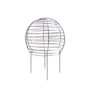

In the UK we fit all our chimneys with a 'cage' or 'balloon' made from strong wire formed into a ball (other decorative shapes are available) with long stiff legs that are pushed into the chimney pot to hold it in place.
wire chimney cage/balloon
The ball shape prevents large birds from building nests on top of the warm flues, ironic since most folks around here call them 'bird cages'!
