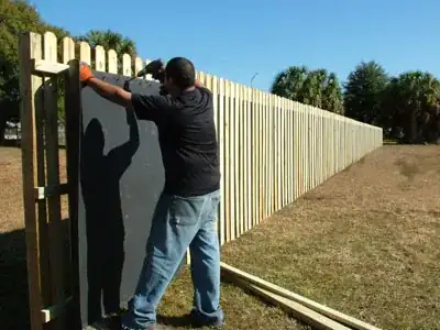

You can buy sound deadening panels or sheeting - You would construct a fence-like structure inside your block wall, then hang the sound absorbing panels or sheeting from that. The material can be part-covered with regular wooden fencing, or plants, or painted, or a combination. You may be able to get away with only performing this treatment on a couple of the walls to prevent the noise from bouncing around. An example of how this can work is below with a sheeting-style product.
http://www.acoustiblok.com/images/acoustic-fence.jpg
Image is of Acoustiblok fence product
