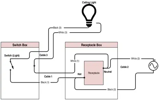

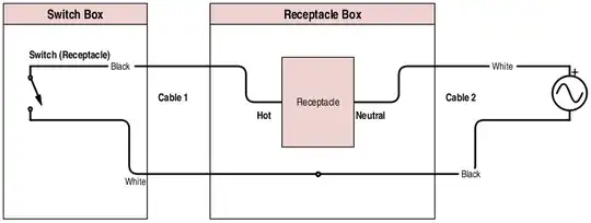

From your description, I can only guess what your wiring is:
If my guess is correct, you'd need to wire it like this:
Note: The black/white wire order in the Switch Box has been swapped in the 2nd diagram! (so the wires wouldn't overlap)
You will need to confirm the wiring yourself using a multimeter.
