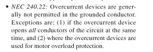

NEC 240.22 Over current devices
This is typically for 2+ phase wiring and not sure how this relates to home wiring.
