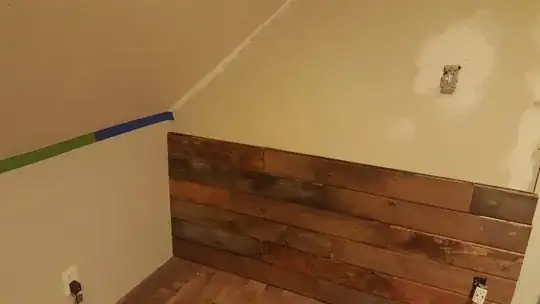

I am adding wood paneling to the wall, as you can see above. Starting with the next panel in the coming row I will need to cut the left end to fit the angle of the ceiling. How to I determine the angle I need to set my miter saw to?

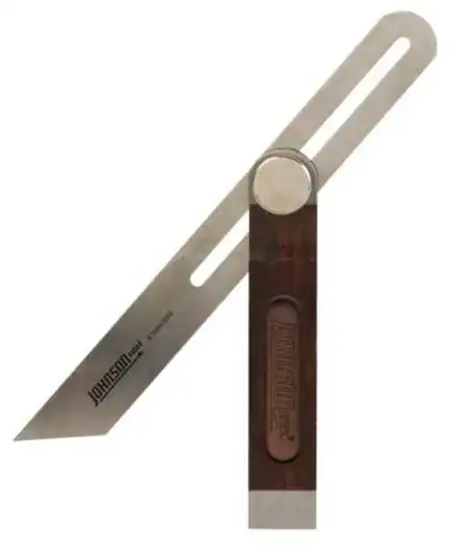

A sliding bevel, which is a fairly low-cost tool designed for exactly this type of job - the blade can be set to match an unknown angle and locked, then it can either be measured, or used directly in setting, or used to draw a line.
Image from zoro tools
No affiliation with or recommendation of the image source.

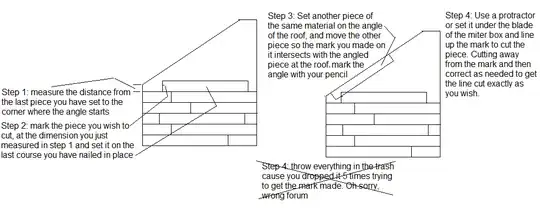

Here is how I have done it before without anything more than what I was already using, the material, pencil, a tape measure and a miter box. Angle cut
