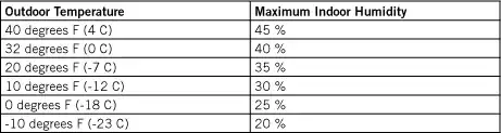

There is no one appropriate humidity level. In the dry, cold north household humidity must be below 20% during certain weather to prevent massive condensation on windows, which can result in damage. Here's a chart showing approximate levels for different outside temperatures:
