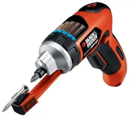

Get a screwdriver with a built in guide for holding the screw in place.
ChrisF
  • 16,973
  • 74
Piotr Kula
  • 5,959
These can be helpful. They are typically magnetic, so they hold the screw in place. They also have a sliding sheath, so it will hold the screw in place until you have completely driven the screw.

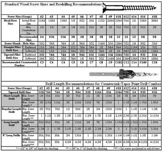

If you're having trouble with just a few screws on something you want to look nice, you can always drill a pilot hole. This way you're just fighting the torque on the threads, rather than the torque required to displace wood around the shank and drive the threads.
