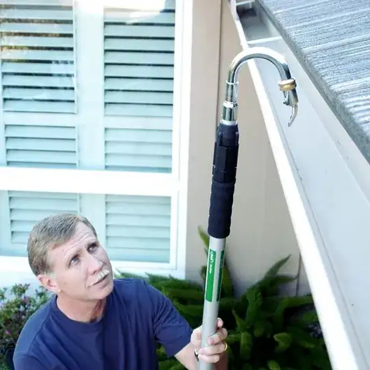

You may want to look at something like the Gutter Cleaning Wand:
man cleaning his gutter
(source: smarthome.com)
You don't need to hire a professional to clean out your clogged rain gutters. Attach the Gutter Cleaner Wand to any standard garden hose, and you'll be able to clear out those debris-filled rain gutters yourself. This heavy-duty hose attachment has a telescoping wand that extends from 41.5 inches to 68.5 inches to get to those hard-to-reach spots along your roof.
  • Rain gutter cleaner attaches to any standard garden hose
  • Spray nozzle directs water flow to blast away debris
  • Gutter cleaning device extends to 68.5 inches to aid in reaching remote areas
