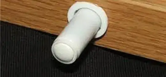

You could also install from 2-> several dampers like these ones depending how heavy the door is or how well you want to dampen it - for example you have a heavy draft that SLAMS the door shut several will be recomeneded to adsorb the doors speed. These work well if installed fairly well.
Either into the frame somehow- slighlty countersinking it so it hides nicely, or not- its up to you and your skills. enter image description here
Or just using a provided housing the will mount flush onto the frame of your door in any position that is best for you.
