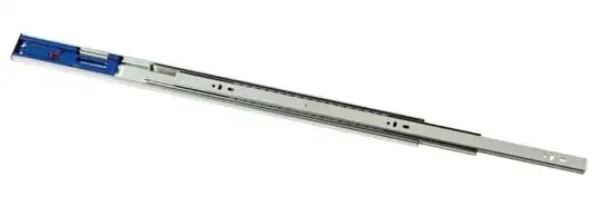

I used these soft closing ball bearing slides:

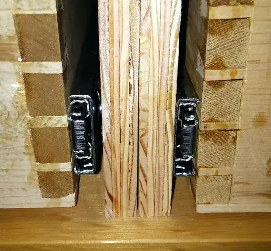

I think it is the rails themselves that are scraping the drawer and cabinet. Looking down them, along the sides of the drawers it looks pretty tight: enter image description here
That is the left drawer edge (with dovetails) at the left and another drawer at the right. The parallel plywood is the center support and "cabinet edges" for both drawers. The extra 1/8 inch width is made up by using the slide's "shim tabs" (for lack of a known name) which is being used on the left slide in the photo. The right drawer's right slide (not in photo) is doing the same thing for the right drawer.

1/16" is going to make a difference here. Very small margins.
Don't rely on those metal flaps as shims. If you need shims, use shims.
You have not done anything wrong, you've just entered the PITA adjustment phase. Higher-quality hardware has adjustments which can be made after the hardware is installed. These slides are not that. You are fortunate that your problem is the width and not vertical because you'd hate to have to move the glide 1/16" up or down - the screw would keep getting sucked into the old hole.
Take it apart and flatten out those "shims." Then put it back together and try it. Based on the math, it won't be quite right. Add 1/16" shims to both sides and try that. If you have measured correctly this far, you'll be done. Obviously if it doesn't work, try 1/16" shim on only one side. Get some serious shim material that you can measure and which won't compress. And whatever you do, don't strip the holes with all of the in and out.
Whatever that other answer said about support in the front does not apply. These glides don't need support. If they require support it's not done properly.

... I made the cabinet openings about 1/8 inch (3.2 mm) wider than the drawers
I just installed a medium-duty slide whose instructional videos state that the gap should be 0.2mm to 0.5mm wider than the slide itself, otherwise the drawer will bind.
I have little experience with slides, but if the slide I installed is typical, your ~1.5mm gap is three times the maximum.

As you pull the drawer out, the weight of the front of the drawer isn't supported. You need to reposition the slides up higher. Since the project is already assembled. After you remove the slides. Attatch the slide rail to a piece of thin wood, then remove the slide rail, attatch the thin piece of wood to the cabinet wall where you wish to reattatch the slide rail, to use as a template to mark the holes. Much easier.
You're still bottoming out the slides & it won't sound like metal, these need some play so the bearings move freely. The cabinet side of the slide might be biting into the drawer side as well. Grinding down the backs of the slides might weaken them too much, so I only see dado-ing (or whatever you might have) the drawer sides as the remedy. If you go too far there you can shim your screws with washers to get everything just right.

When I installed these I had a scraping issue as well. It's been some time back but if memory serves the scraping issue was related to a screw. I solved it by:
1) place the screws in the hole at the extreme end of the tab (not the hole closest to the meat of the slide, but the hole that would allow the slide to flex the most).
2) do not prebend the shims! This was an important discovery for me. Mount the slide to the cabinet and drawer. Then install drawer by wiggling it back and forth until it grabs on both sides. At this point it will feel like it's binding a bit. Perfect! Now use force to push the drawer back until they are all the way back.
When you do this the tabs flex by themselves to the optimal position and you are set. I believe the screw issue was that by putting the screw in the first hole, they end up getting torqued at an angle and that causes them to scrape on the slide.

Good thing you left an 1/8" on both sides.
Put washers in between the drawer and the slide, under each of its mounting screws, to offset it away from the track. Use small enough washers, that they themselves won't scratch on the glides.
I'm not sure how else you'd use a track that doesn't present a proud attachment point.
