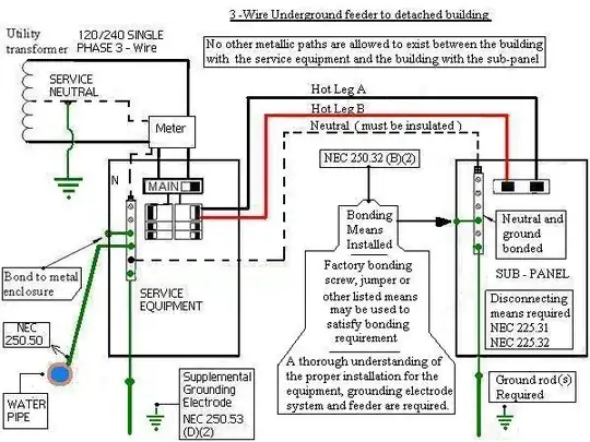

What is the correct setup for neutral and ground in the sub panel? Should they be bonded, and do I need to attach a ground to the buried rod at the garage as well?
Specifically, I need to know if this image shows a correct setup before I proceed. This question has been touched upon in other posts, but not adequately answered:
3-wire feeder diagram
(source: nachi.org)

If you are in a situation where a 3 wire feeder can be used, you will need to bond the grounded (neutral) conductor to a proper grounding electrode system in the detached building. So yes, the diagram is correct.
NOTE: The grounding electrode system, may be required to be made up of more than a single ground rod.
