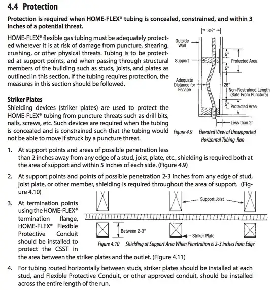

Here's the relevant part of the documentation (full doc is here):
Relevant manufacturer requirements

The manufacturer's installation manual describes the plate that can be used, and even includes the part number.

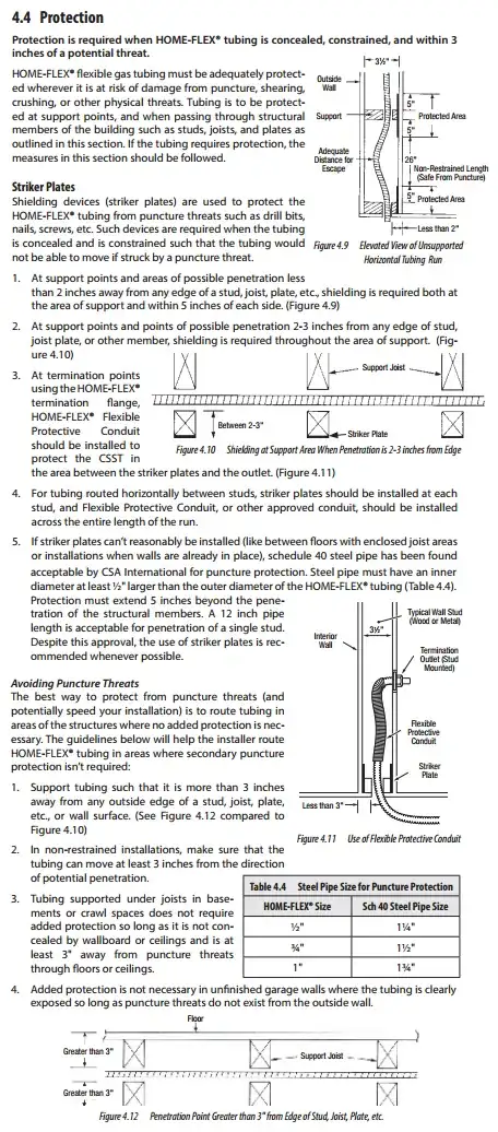

It also says in the Protection section of the document "For tubing routed horizontally between studs, striker plates should be installed at each stud, and Flexible Protective Conduit, or other approved conduit, should be installed across the entire length of the run." (see point 4 below), and "schedule 40 steel pipe has been found acceptable by CSA International for puncture protection.". So you could always use schedule 40 steel pipe to protect the pipe. Just cut the pipe in 12" sections, and install the tubing in the pipe where it passes through studs.

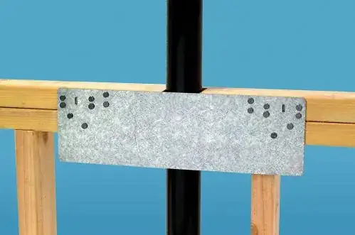

An alternative product to the other answers / references is a Simpson Strong-Tie PSPN516Z "Galvanized 5 in. x 16-5/16 in. 16-Gauge Protecting Shield Plate Nail Stopper".
example installed

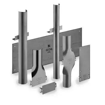

These type of protection plates are sold at most electric supply stores, and probably with plumbing supplies as well ( I see them exclusively in the electric department at Lowes or Home Depot). Here is a link to a product page for a protection plate. Here's what it looks like:

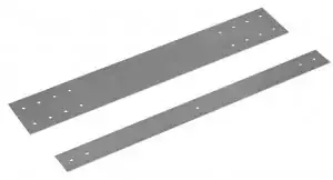

Use a flat steel plate designed for framing applications (Simpson Strong Tie makes plenty). They are abundant in lengths to satisfy minimum (11 1/2") for 2 x 4s.
