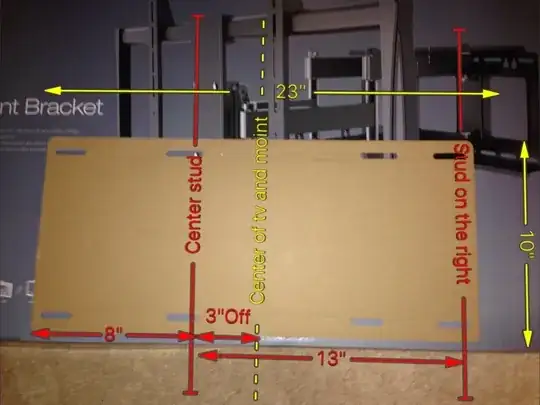

These two pictures represent the options I am considering. option 1

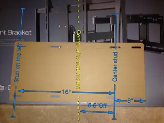

Option 2
As you can see, with Option 1 (red arrows) the TV will only be 3" off center to the Center Stud but it leaves 8" of the wall mount unsupported. Would this be an issue when I pull the TV out? Would strap toggles be necessary on the left side of wall mount? Option 2 (blue arrows) looks for secure to me, but is further from center so I would only consider it if Option 1 is not safe. Thanks!

It isn't necessary to center the mount on the studs. As long as you hit the studs, you'll be fine. Make sure you locate them as accurately as possible.
UPDATE: Both of the options in your update would be fine. As long as you hit two studs, with the center of the mount between the studs, it will be solid.

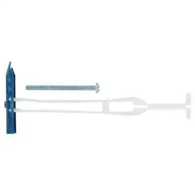

Two well placed lag bolts can handle most of the stress, but you should supplement them with wallboard anchors at both sides of the mount. I would recommend using two on each side and would use strap toggles.
strap toggle
The straps are shifted so the metal toggle section is parallel, inserted into a predrilled hole in the drywall. The straps are then shifted, turning the toggle perpendicular to the strap and parallel to the inside of the drywall. The toggle is then snugged to the wall by pushing the collar to the outside surface of the drywall, and the excess straps are broken off. The bolt is then inserted through the mount and into the toggle.
These will hold the mount tightly and spread the outward and twisting stresses over a large area of drywall. The lag bolts will still carry most of the stresses. You should be fine.

4 lags in two studs is sufficient. The 8" mentioned is not "unsupported" it is cantilevered with plenty of support.
